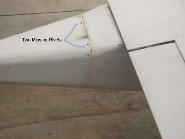

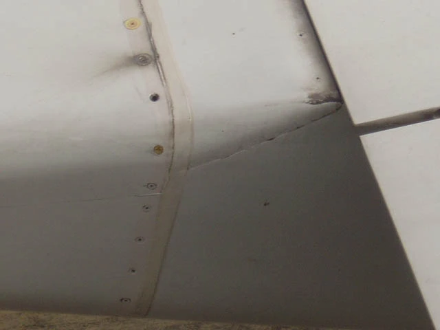

Please see the attached pictures. Would these two missing rivets be a safety concern?

That is not an engine pylon. It is a flap fairing and it covers the flap tracks to reduce aerodynamic drag. It would be better to have all holes filled with a screw but in this case it is not dangerous. There are about 22 other screws holding it in place. In any other industry, there would only be four screws. In safety minded aviation- 24- just in case some nutserts get stripped or screws vibrate out.
Occasionally, this fairing is damaged by ground equipment and removed all together until maintenance can be performed at a later time.
This kind of thinking is dangerous. One can not down play the importance of this issue and I can understand why the FAA will point this out when they do a flight line walk around. These areas of the airplane are under tremendous aerodynamic stresses and require attention if something is amiss. Why are screws/rivets missing? Someone certainly did not remove them; on inspection, most likely the hole will be elongated. If these problems are not corrected, eventually there is the possibility of this part separating from the aircraft. It is true that you can leave the screw/rivet out, but only after engineering evaluates the defect and issues an ERA that states it can be done.
