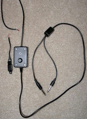

I went out to the hangar yesterday and found a 10 year old stereo headset that was replaced by a newer model long ago. I felt like a kid again riping it apart. I salvaged the rubber grommets and the volume control and drew out a schematic of the original wiring before taking the electrical harness apart. I went to Fry's electronics and bought some long heat shrink rubber tubing and nothing else, mainly because they didn't have any of the other stuff I was looking for! Unbelieveable!
Next stop, Radio Shack. They have it all. I bought a Project Box:
A 1/8" Stereo Panel Mount Jack:
A bag of assorted Grommets:
And a 6 foot stereo cable with two plastic coated wires and a shield for the mike.
Got my smarts from Wikepedia: (since I don't know Jack about Jacks)
I went to Target and got these battery powered noise cancellation earphones. I have a friend who rides Harleys and swears by them.
Then I remove the factory rubber plugs and replaced them with these earplugs from Walgreens. I took a soldering and burned a hole down the middle of the ear plug to allow the sound to reach my ear drums.

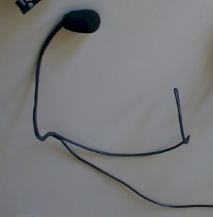

Here's what it looks like, minus the mike being attached to a "around the neck and over the ears" wire headset. The volume control is a real necessity for this headset! The all you have to do is plug the earphones into the phone jack plug.
Heres the headset, made out of an old coat hangar.
