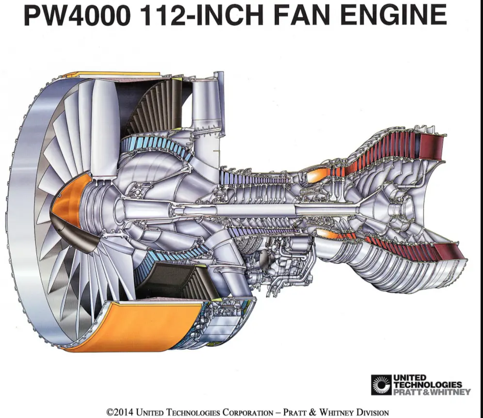

From UA Tech Ops:
Engines
With United as the launch customer for the Boeing-777 aircraft, United Technical Operations’ experience with the PW4000-112" engine is unequaled. We are the only MRO facility in the United States equipped to work on this engine type.
Engine testing capabilities, including the only PW4000-112” test cell in North America
Test cell is pretty awesome.

P&W developed [a thermal acoustic imaging] inspection process in about 2005 to be able to inspect the interior surfaces of the hollow core PW4000 fan blade. The records for the TAI inspection in July 2015 as well as an earlier TAI accomplished in March 2010 revealed a thermal indication in the same location as where the LCF crack occurred. The records for the fractured fan blade’s July 2015 TAI inspection was annotated “paint” that, according to the inspector, was consistent with him accepting the indication because he thought it was an issue with the paint.
[P&W] classified the TAI as a new and emerging technology and therefore did not have to develop a formal program for initial and recurrent training … The 1st shift inspector was trained by the engineers who developed the process and the 2nd shift inspector, who was the one who last inspected the United Airlines fan blade that fractured, was trained by the 1st shift inspector. Both inspectors stated that their training on the TAI was about 40 hours of on-the-job training. In comparison, the certification requirements for the commonly used eddy current and ultrasonic inspections are 40 hours of classroom training and 1,200 and 1,600 hours of practical experience, respectively.
