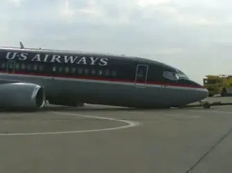

US Air Nose Gear Collapse At PIT
Here is another pic...I was there when it happened! Thank God everyone was o.k. :shock:

The plane is not ok. There appears to be a crease in the skin near the impact area, let alone it also landed on the towbar.
There are a lot of critical structural elements surrounding the nose wheel well....particularly the sta. 178 bulkhead. If that area was damaged, everyone should get a Snickers bar.....because it's going to be a while before this bird flys again 😉 .
It also appears that the #2 VHF COMM Antenna is contacting the ground which could mean damage to the belly. The lower TCAS and ATC antennas are also history.
More than likely the something in the "draglink" assy. failed and caused the collapse. Judging by the pic I would say it did fold as "neatly" as it could of into the gearwell.
those are very excellent photos BoeingBoy. Is this plane now essentially a write as it looks from the damages? Also looks as though the number two engine may be damaged on the cowling
What are the chances that they'll part 'er out on the spot if the damage is too great? 🙁
