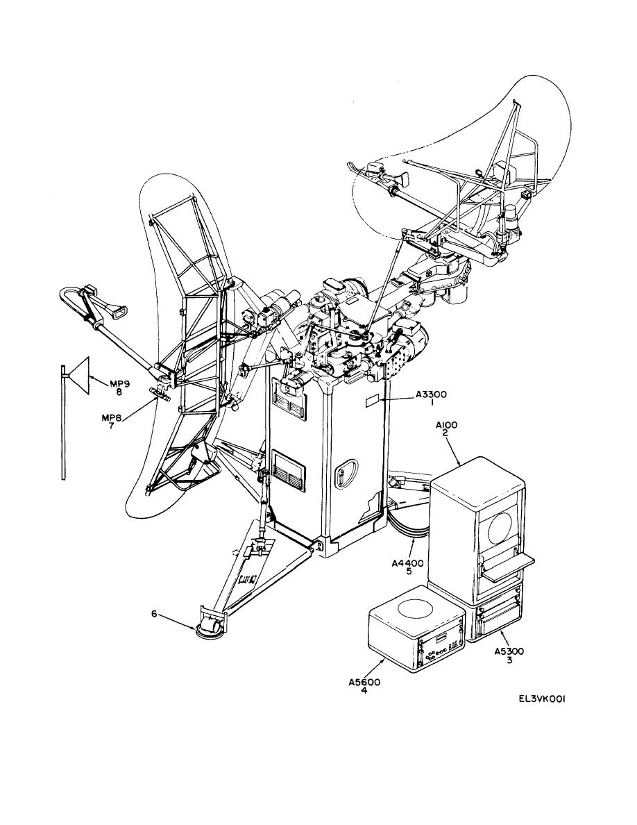

Not sure but most likely Vietnam is using the FPN-40
Used to fix those in another life... :p
150NM GCA/PAR radar.
