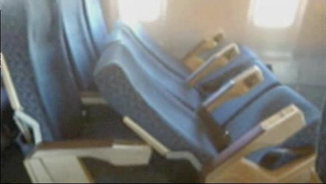

Here's a photo of one plane's loose seats:
http://gothamist.com/2012/10/03/more_american_airlines_seats_coming.php
Those are the old 757 seats, not the new CIP seats.

Thanks. As of mid-June, there were 33 active 757s that had been thru the CIP; does anyone have current numbers?
The photo I posted above were definitely old interior seats.
