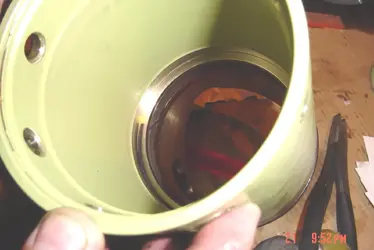

OK - back to the question - why would any mechanic safety wire the valve shut unless they had the work order to do so? Is it not about program management? Somewhere, somebody in the work flow said that the valve needs to be wired shut.
The MEL would be one reason a valve would be wired open or closed depending
on what kind of valve it is.
MEL could be a reason "In a normal operational environment", but is strictly forbidden leaving a HMV.

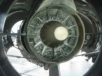

Next: Engine after takeoff from OSV,and the next round of trying to justify the "Shoddy Workmanship" of the OSV's

So, once again....was the safety wiring a result of shoddy workmanship by mechanics, or poor oversight by managers, engineers or the A&P that checked it off?

Segue - You "assume" that an A&P signed off the work. FAR Part 145 allows a person that meets that repair stations "qualifications" per their GMM(General Maintenance Manual) to possess a "repairmans certificate" and thusly are allowed to release work or the entire aircraft for return to service and NEVER have an A&P license. The question remains was the valve installed after run ups and test flt? Why was it not "op ckd" after installation, per the MM? The safety actually appears to be that of the type that is seen from the shops that overhaul them. The underlying FACT is that due to engineering having to put "redundant" systems in an aircraft a disaster was averted. The fact is that in almost all aircraft accidents there is no "singular" cause but a steady build up of multiple causes. This gives proof to the arguement for redundant systems, yet when poor workmanship in multiple systems or a large amount of "deferred" items come into play this could and does ultimately lead to major problems and/or disaster. This is the main basis for any arguement of the importance of having technically qualified and trained people perform maint on an aircraft. People that are not trained or qualified do not and can not comprehend the complexity and interaction of the many systems on an aircraft especially those of modern day.

Rather than attribute it to nationality or race, exactly why do you think that work was done? As for "quality", the safety wiring looks pretty meticulous and intentional. I'm not trying to support it or anything, just curious.
Dude all safety wiring is INTENTIONAL. The question is why was the valve safetied closed. Lack of english comprehension skills, incompitence?
